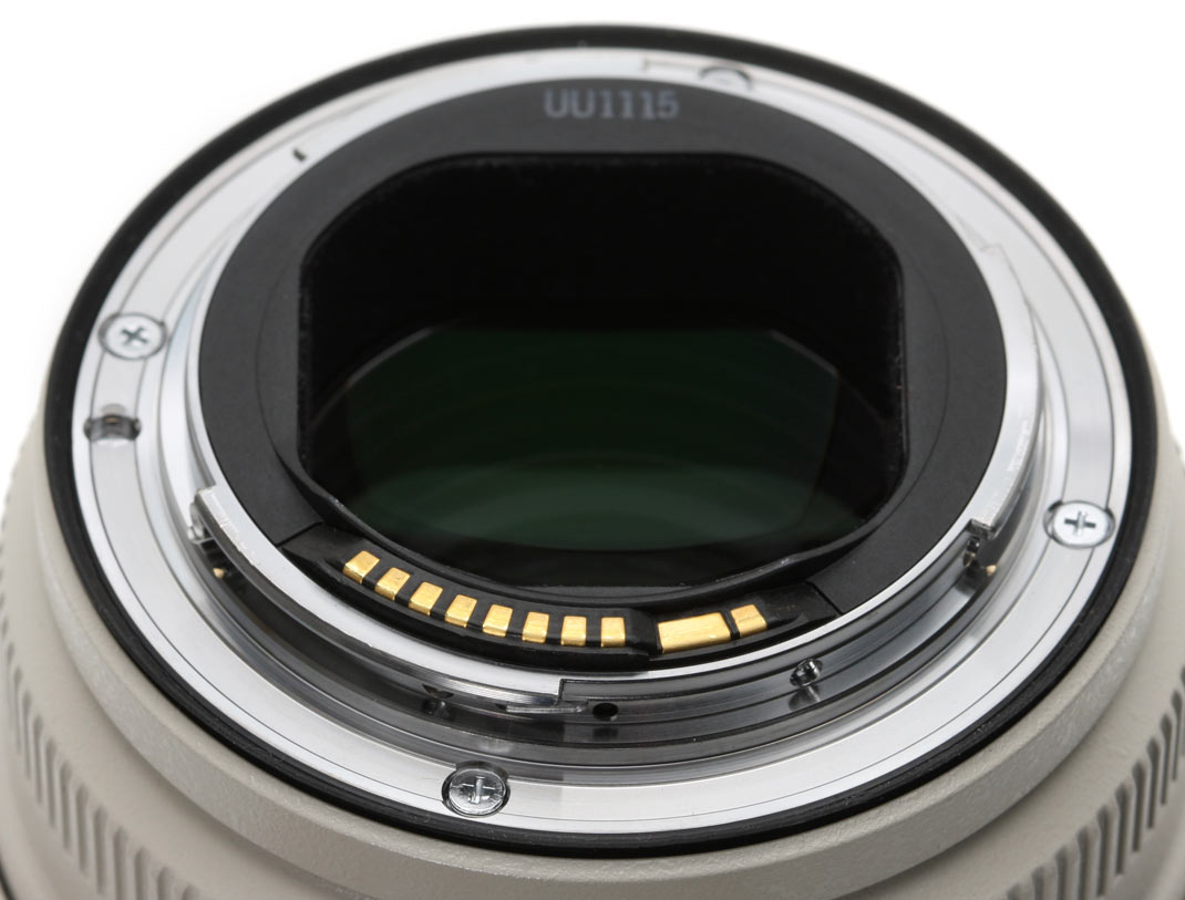

adan Posted February 21, 2017 Share #3 Posted February 21, 2017 (edited) It rather depends on what "weather-tight" means. A basic rubber "skirt" around the lens mount, that seals the gap between lens and camera, is likely not hard to incorporate, and is something that could easily be available as an upgrade. But since rubber does eventually either wear out or degrade, it would run against the ideal of lenses that last for 50+ years.You'd have to plan on getting a new seal installed every decade or so. http://2.bp.blogspot.com/-PYyScLHE4Io/TeEpnQe5SLI/AAAAAAAABGQ/jivjVFQcNZU/s1600/weather+seal.jpg As to sealing the lens barrel and moving focus or aperture rings - most manufacturers have addressed that by removing the rings entirely. Or at least removing the mechanical connections and going to "focus by wire" by way of the autofocus motors (ring moves rheostat, which signals lens to move), with aperture controlled from the body via a control wheel. I supremely doubt Leica will go that route. There's another issue with "sealing" anything that changes in volume - how to handle the changes in air volume inside the lens, or lens/camera-chamber combo. If you add 1 cm to the length of a lens by focusing from infinity down to 2 feet, either air has to be able to leak in and out to fill that space as the volume changes, or you may get a partial vacuum inside the lens. That will fight you when you try to focus. Internal focusing (where the whole lens stays one size, while the glass moves around inside) addesses that. In the Nikonos lenses, as well as AF lenses. Even so, some of Canon and Nikon lenses are notorious "dust pumps" that suck in dust with the air as they are zoomed in and out. After a couple of years, they get a lot of internal dust on the glass, which requires a major strip-down for cleaning. Conversely, when Fuji introduced the weather-sealed 18-135 for the X cameras, they intentionally put 3 little pinholes in the botton of the lens barrel, to allow air to suck in and blow out as the lens was focused and zoomed (since updated as a slotted vent, that also dumps overboard water that collects on the extended zoom barrel). https://photographylife.com/what-to-do-with-dust-inside-lens http://onthreelegs.com/2014/11/23/fuji-18-135mm-review/ Leica has always depended upon the kindness of strangers - no, wrong play - their tight mechanical tolerences and "fit" to keep environmental water out, at least from the deepest parts of a lens. Combined with grease (oil and water don't mix). https://petapixel.com/assets/uploads/2011/05/cutaway3.jpg Generally, it works pretty well. My M8 and decades-old 21mm lens were "sloshed" with a large dose of whitewash during a college event. No problems, except for external cleaning. A couple of years ago, I was shooting in a serious Ouray snowstorm with M9s, and a Canon w/300mm IS - the Canon AF started acting up, the M9s and their lenses were unaffected. (Video frame grab) Welcome, dear visitor! As registered member you'd see an image here… Simply register for free here – We are always happy to welcome new members! Edited February 21, 2017 by adan 6 Quote Link to post Share on other sites Simply register for free here – We are always happy to welcome new members! ' data-webShareUrl='https://www.l-camera-forum.com/topic/269639-weather-tight-m-lenses-is-it-possible/?do=findComment&comment=3217922'>More sharing options...
