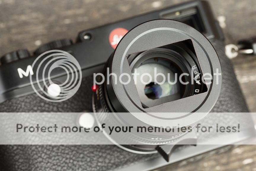

padam Posted February 1, 2017 Share #12 Posted February 1, 2017 (edited) The simple truth is, the built-in hood is just inadequate, as said before. But there is a custom fix for it using another original front lens cap, and milling it for extra shading. (Seriously, should one resort to find such solutions for a lens like this...) But anyway, this is with the stock hood And with the extra shading added Kind of late, but I guess they could still bring out an updated version with a bayonet hood, if they really care about fixing it 'properly'. Edited February 1, 2017 by padam 6 Quote Link to post Share on other sites More sharing options...

helged Posted February 2, 2017 Share #15 Posted February 2, 2017 The simple truth is, the built-in hood is just inadequate, as said before. But there is a custom fix for it using another original front lens cap, and milling it for extra shading. Interesting! Can you provide the dimensions of the opening...? Quote Link to post Share on other sites More sharing options...
Lord Lucan Posted February 3, 2017 Share #16 Posted February 3, 2017 @padam, This could be an accessory of the year. The cap reminds me of,it is actually a lenshood,that comes with Sony ZE Distagon 35 f2.8. Quote Link to post Share on other sites More sharing options...
helged Posted February 6, 2017 Share #17 Posted February 6, 2017 Via padam (thanks!), I learned that the fix in post #12 originates from a blog at Banum (in Swedish; a google translate should do the job for non-Scandinavians). I contacted Bo, and he informed me that the size of the milled (original) lens shade is 32x26 mm. I will do some testing at various apertures and distances - and eventually do some milling on a spare lens shade myself - and I will report back on the findings after some testing and when time permits. Those using filter(s) on the APO 50mm-M, like b&w filters on an M monochrome, may have to increase the opening since the filter puts the lens shade forward on the lens (I may look into this). Furthermore, the lens shade should not rotate, and this may require a fix. And finally (?), some may want to put a cap onto the milled lens shade for protection. So although clever, the lens shade fix has its limitations... Feel free to chime in in case there are other fixes/ideas/experiences out there! See also a demanding test of the APO 50mm-M vs Otus 55mm a little down on the page here. Quote Link to post Share on other sites More sharing options...
