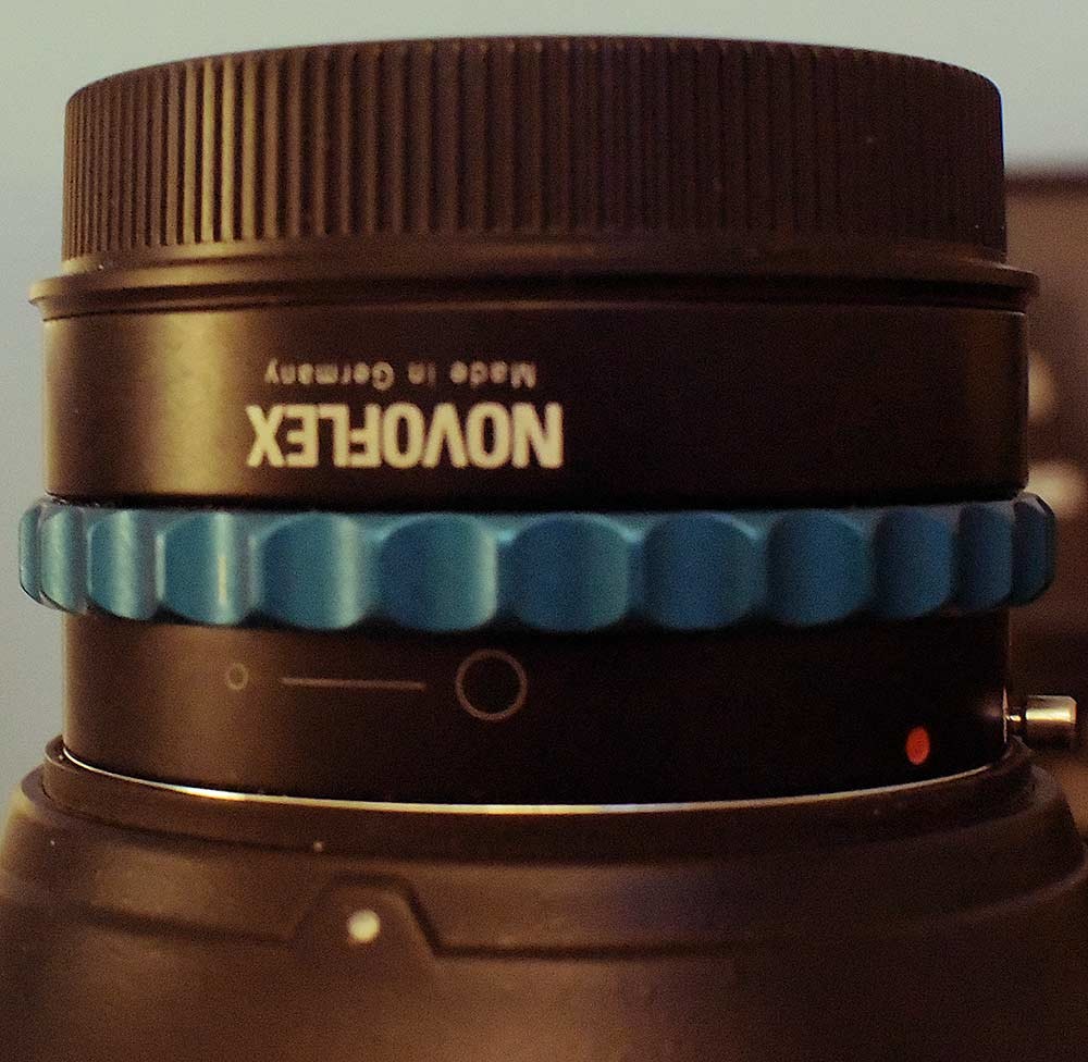

Ario Arioldi Posted December 17, 2016 Share #13 Posted December 17, 2016 (edited) Yes, please pass a word in case someone has played with the Novoflex Nikon AF Lens Adapter to Leica SL Body adapter! I have one and use it with the newest 105/1.4. The AF is reasonably fast and consistent, only a bit noisy. The experience I am having with it is so far much better than the one with the EOS/SL adapter. Edited December 17, 2016 by Ario Arioldi 2 Quote Link to post Share on other sites More sharing options...

helged Posted January 17, 2017 Share #20 Posted January 17, 2017 As a follow up - for those pondering on using a Nikon E-lens on Leica SL - and assuming that the Nikon 300mm f4E PF is representative for the Nikon E-lenses: The Novoflex SL/NIK adapter is (very) well produced and it works as announced, no problem. The autofocus is ok and useable, although a mix of auto and manual focus will be needed for general shooting. For each shot, the aperture blades closes and opens again, implying reduced shooting speed compared to native SL-lenses (or manual lenses). No problem for me, but this could possibly be a constraint for others. Given the relative short and light-weight lens, the 300mm f4E PF will likely be my 'long' lens when hiking, possibly with a 1.4 converter attached. With the converter attached, the autofocus is less useable. The optical quality with the 1.4 converter seems fine, though. Below a shot in light drizzle (f4,1/500s, ISO5000, handheld) - illustrating out-of-focus rendering of the lens. Welcome, dear visitor! As registered member you'd see an image here… Simply register for free here – We are always happy to welcome new members! 4 Quote Link to post Share on other sites Simply register for free here – We are always happy to welcome new members! ' data-webShareUrl='https://www.l-camera-forum.com/topic/264481-novoflex-nikon-e-to-leica-sl-adapter/?do=findComment&comment=3188473'>More sharing options...
