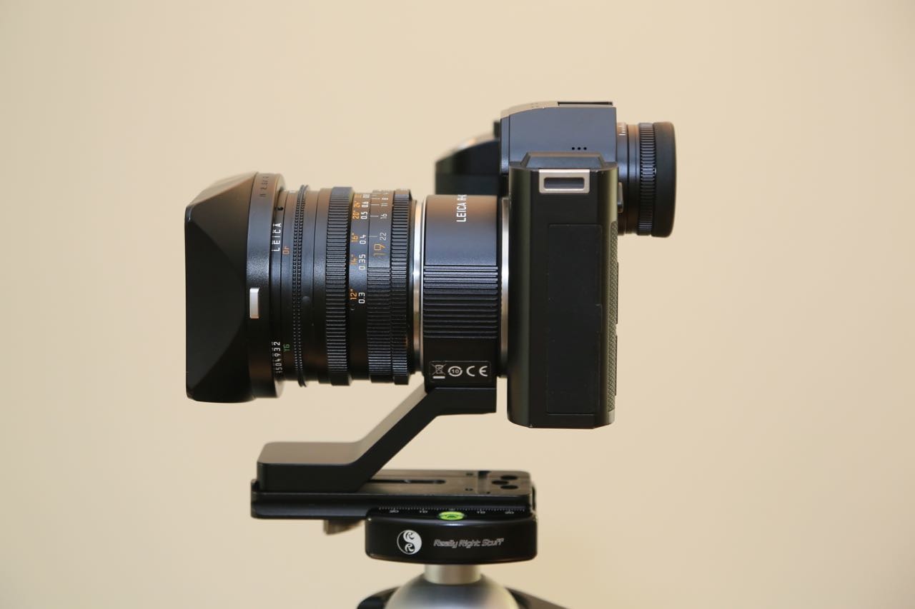

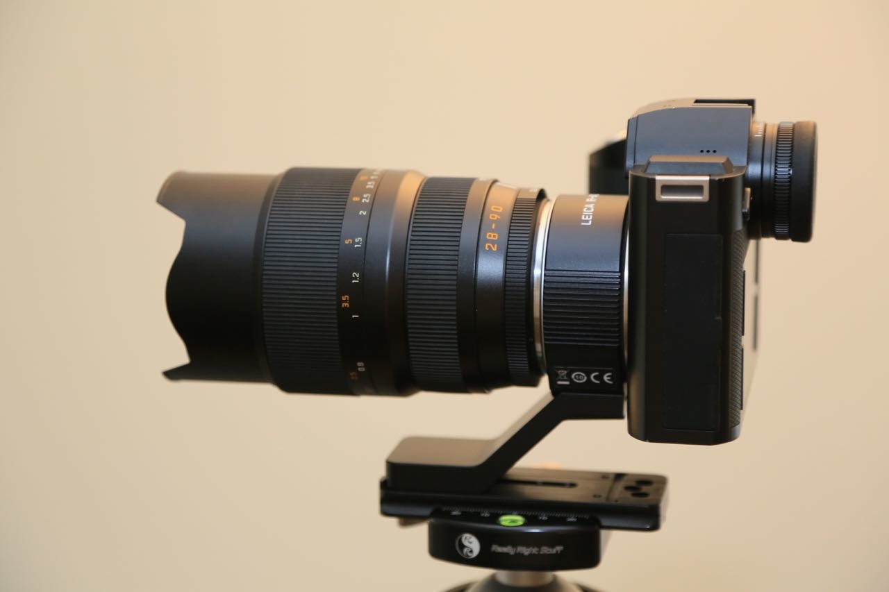

Yesterday I had the opportunity to make a short test of the new adapter R --> SL at the Leica Shop Wetzlar. I had no R lens with me and so I got a R 4,0/35-70 from the shop. The SL recognized the lens automatically and also the used focal length of the lens. I can't realize any correction profile, there is no message given to Lightroom like this is done with coded M lenses.
